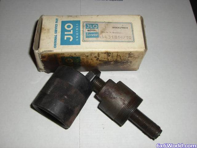

      Johnny 2 Stroke, Hey thanks for the info. My engine is a 395, thats what the #s on the head and the base of the cyl. say. I do have the theads face inwards on the fly wheel. I was thinking today that might be the way to pull it If you could post a picture of the tool and or the part # I wil be eternally Gratefull and will not have to destroy a good flywheel. Thanks Skip.
        Hi Skip:

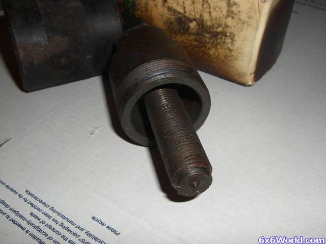

        Sorry I didn't get to this sooner, I had to dig it out again. This is the JLO Factory Flywheel puller. I was going to cut one on my friend's lathe, but I needed to get the gear ratio for the thread pitch ($$$) Long story short before I did it I found one. Factory # is 444.31.814/10, but good luck finding one, unless you have a LONG-in-business sled shop near you. (It WILL turn up, it's just a waiting game)
        Plan B is if you can find a bolt the correct pitch/diameter, you can center drill, tap for a large high-grade bolt, and drill one end wider for the crank to fit in. You DON'T need the collar, it's for other engines that have thread facing OUT around the crank nut, but you DO need the point on the center bolt, otherwise the bolt will walk on the crank, side-load and try to pull the flywheel off at an angle, maybe just harder, maybe do some damage, not sure, but the points a must.

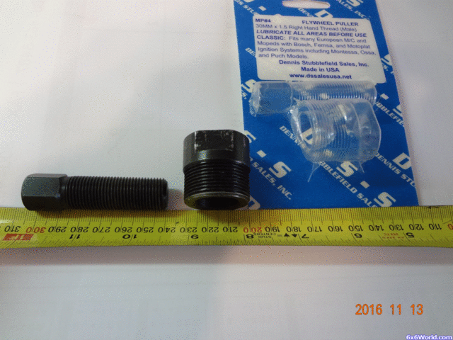

          After (what I thought was) careful measurement of the diameter and pitch of the threads in a JLO L152 flywheel, I purchased a Dennis Stubblefield Sales MP#4 puller, 30mm x 1.5mm pitch right hand male thread.
          It only threads into the flywheel about one turn, then binds.
          My question: Could Johnny 2-stroke, or anyone else who owns the factory puller, please measure the diameter and pitch of those threads and post back with the results?
          Thanks.
