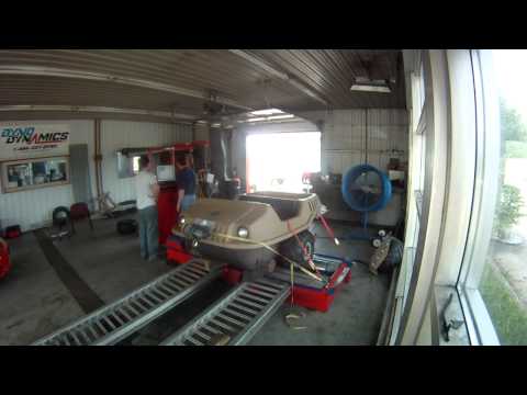

Hey Keith, glad you joined in, hadn't really intended to bring this thread back but here we are. In my case it would be very difficult to hook up to any dyno since I no longer own any of these machines, nor the components. The housing I used had 0.002" clearance between the OD of the blades and it's ID. There was always a stumble at initial acceleration, this was not the case if I powered up the fan then hit the throttle, so I have no doubt that something had changed. Also the measured distance from standstill to max rpm was shortened by some feet. We did 20 repetitions each with and without the fan being powered both sets of results were fairly consistent, I was surprised at that! Honestly I was quite skeptical of this whole thing when the guy who told me about it was actually doing it on an S-10 of all things and swore he could feel a difference, he had also tried on of the whirlygig things and said it was bs and that is what gave him the idea. I changed my mind when I immediately noticed the stumble was gone. We did timed tests and took all sorts of notes, and as I said they are probably still here, if they didn't get tossed like a lot of other stuff when I moved into the new shop. As I said I'm not going to bother looking for it, as I don't see where it will be of any benefit on my current project.

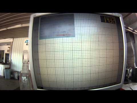

It may be important to differentiate between driveability and measured performance. Typically you will use the engine dyno for measuring power. Like peak hp and torque. Single sweep, starting at a few thousand RPM and going to just over where peak HP is made. I consider this the performance of the engine. Driveability is a different animal to me and where we use the chassis dyno most. With an eddy current chassis dyno we can see what happens off idle, at speed, light load, heavy load, acceleration, deceleration any thing you like. This is where engines that have the exact same performance can differ immensely. Now lets say just for fun that most 4 stroke engines used for AATVs are really designed for things like lawn mowers and generators. Applications where they run at wide open throttle. Carbs, air box, intake all designed to run at WOT. My guess is what a person would "feel" has nothing to do with the actual HP or torque the engine is making especially given the loss through the drive. Now lets say just for fun that you place a small fan in the cold air intake of an engine designed to run at WOT. All of the sudden at the moment you open the throttle blade there is air flow past the venturi which gives a stronger signal for more fuel in a carb that has no accelerator pump. Walla, no hesitation. Now does this 18HP engine make more power? Probably not but it would sure "feel" more powerful.
