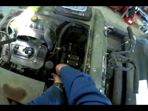

    I've never had much to do with smal engine work, did I miss anything.
    Looks like I have weak rings on one cylinder, not too bad yet, but it is below spec.
    Good video RD! kinda makes me wanna test my magnum with 625 hours on it
      RD you're right on track. 10% of 180 from the good cylinder would bring your lowest allowable spec for weak cylinder to 162. I wouldn't condemn the rings yet unless you are having runabitily problems.
      It's all just nuts and bolts.
        what you really need to do is warm the engine pull both plugs do compression test..
        then do a leak down test...a leak down test is more accurate...then put a little engine oil down
        into each cyl..about a tea spoon..then do another compression test and see how close they are..
        if cyls are now the same you have a ring problem..
        then do another leak down test if it stays the same as the first leak down test then you have a valve
        problem..when using a leak down tester you should not have more than 20 to 30 % leak down on each cyl around 8 to 15 % is good
