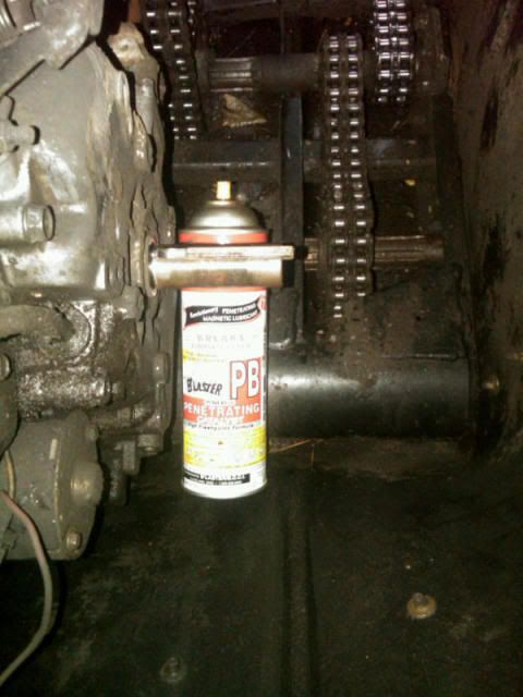

You can get a new bolt, same thread but longer than the clutch bolt and bottom it out by hand (DON'T WRENCH DOWN) and hit harder. You won't damage the engine if you don't get ballistic, but if you miss on a swing the clutch is toast, so still keep it sane. PB Blaster is your friend. It's like WD40 but in my opinion FAR FAR superior. I use PB almost exclusively now.Attex 295 Wild Wolf: sigpic My Runner

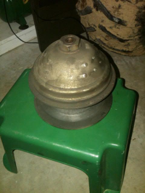

I guess I should have asked first; how to tell if the clutch is beyond repair? I see no cracks in this primary, but the edges of the inner pulley have scars. It might be burnt belt. I won't know until I can have a chance to dig deeper. Also, you can see in the vid that both pulleys are grooved in two spots. Is that repairable with sanding?Last edited by waylonh; 10-27-2010, 01:53 PM.

Elementary good man. Some times persistence pays off. Glad you got it off.Life should not be a journey to the grave with the intention of arriving safely in an attractive and well-preserved body, but rather to skid in sideways , cigar in one hand, whiskey in the other, body thoroughly used up, totally worn out and screaming "WOO-HOO, what a ride!!!"
 Another convert to the world of PB
