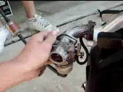

if you are still looking for an extra cool machine, try to find a Sachs rotary engine out of a Johnson/evinrude/articcat panter snowmobile.
YouTube - Single rotor lawn mower-YouTube.mov2008 MAX-IV 500T 30hp Bandolero
