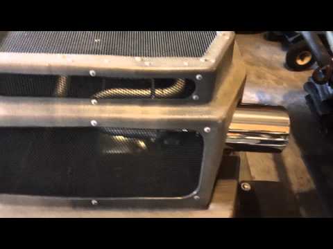

                              • #45
                                Here is a short clip with audio of the engine at idle with the new exhaust.
                                If I can get Jason away from the XBox I will have him help me get a few more shots under load and such.
