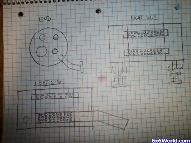

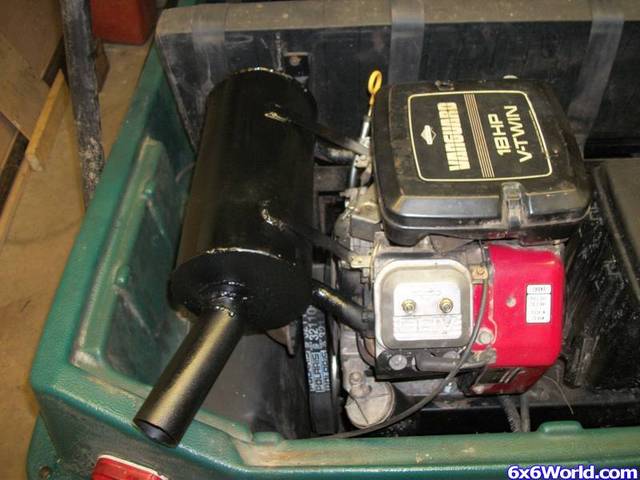

The exhaust on the Max IV was whipped and, I always wanted to try to make my own exhaust. I wanted it to be as quiet as possible and still allow "room to grow" in the future. This turned out great. It has a deeper tone and is very mellow. It has no packing to go bad and should last a long time. I can actually hear the tone change as the clutches ramp up! Spent about $80.00.
Home made exhaust
