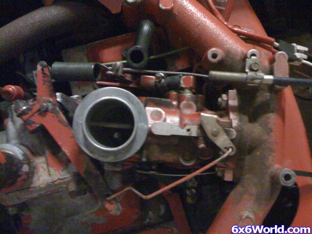

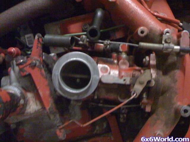

    I recently got a Max IV that has a Kohler Magnum 20. It will run but the throttle does not go back to idle when you release the throttle. I am guessing a spring is missing. Is there a spring that pulls the throttle back to idle?
    Think i figured out how to post pics. The first is the throttle at idle position. with the second after really just pushing the throttle open.
    Throttle at idle
    Throttle open and not going back to idle\
    Hope this works!
      I have been searching and came across this post here where someone else had a spring on the governor to pull it back. Route 6x6 Discussion Board: Kolher 20 magnum throttle/gov linkage
      I might try to put another spring there, but like the post says its not one in the manual.
