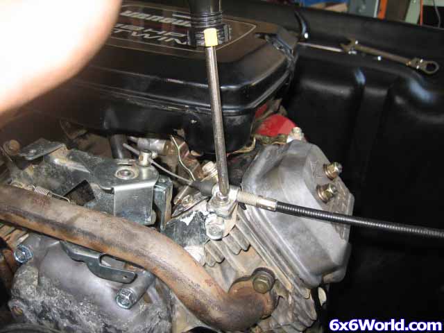

Start by disconnecting the ground strap and the throttle and choke cables at the motor. Then disconnect the wire at the starter solenoid, the electrical connector at the front of the engine, and the fuel line (1,2,and 3 respectively in the picture).

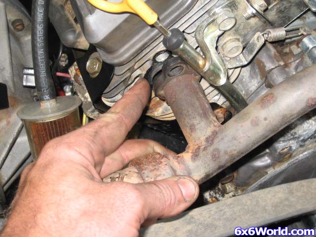

Remove the four bolts that hold on the exhaust. Two are circled in the picture below. Then gently pull it away from the motor and be sure to remove the two exhaust gaskets that will later be replaced.

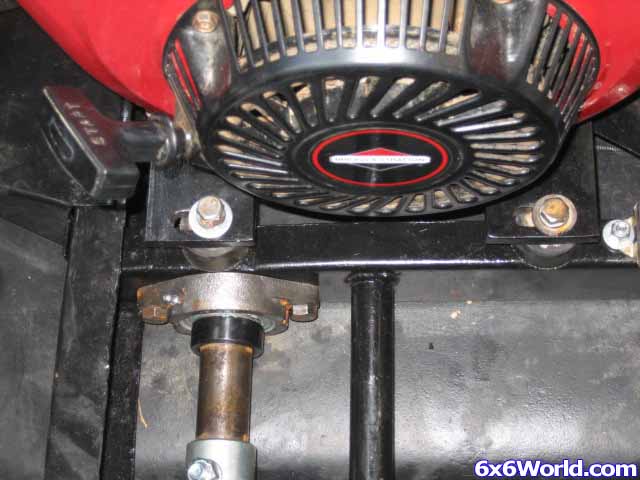

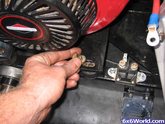

Remove the four bolts that hold the motor to the mounts.

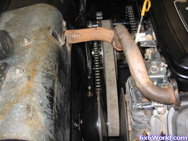

Remove the belt by sliding the motor forward and rotating it clockwise. This should give you enough room to just slide the belt off. Just be careful that you don’t damage the clutch or exhaust.

Place the motor back in the Max and slide the belt back on. Then position the motor over the mounts and insert the four bolts and washers. Leave them loose for now so that you can adjust the position of the motor.

Place the exhaust gaskets between the exhaust and the engine and bolt the exhaust back into place.

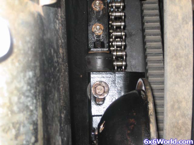

Tighten the motor mount bolts while keeping tension on the belt. Then slide the stop on the left side of the frame towards the rear until it touches the motor mount. (See the photo below) This helps to keep the belt from pulling that side of the motor forward over time.

Reconnect the fuel line, starter solenoid wire, and wiring harness plug. Then reconnect the throttle and choke cables.
