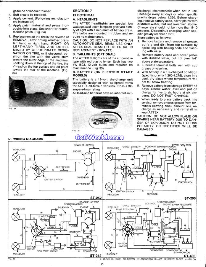

Does anyone have a wiring diagram including the wiring harness for a attex chief. I would like to have the diagram for future reference. The engine has no spark but it ran before the engine was taken out 4 months ago. All the lights work and the starter turns over the engine fine. I thought I was careful when I cleaned engine and washed it. Where should I check first ? I dont have alot of experience with electrical problems.
Thanks for any help !!
