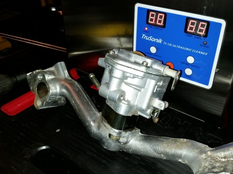

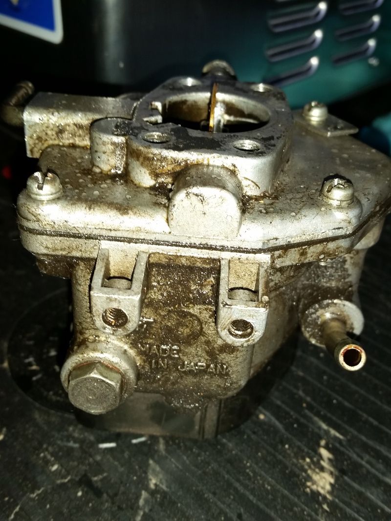

Every single machine I purchase gets a proper carb job as step number one if there are any running/drivability issues. I have a large heated ultrasonic cleaning tank I use for cleaning everything from complete carburators to handguns and even brass for reloading. Here are a few before and after pic of my 18HP Briggs Vanguard carb from my 1996 Argo. This machine had sat in a barn for a couple years before I picked it up. It was complete but the engine ran a bit different each day lol.
Here are the results of a 30 min dunk.
