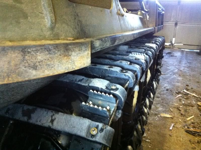

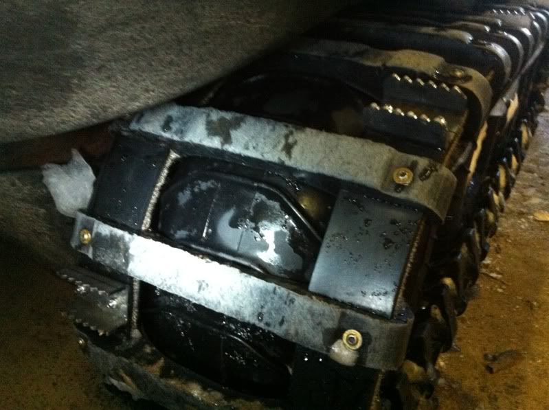

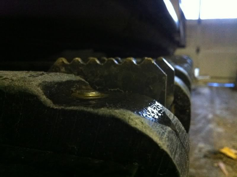

                            Today was the firs time I've had a chance to ride since I started this thread. It's warmed up here, and the kids wanted out. I reciently received a couple boxes of goods from the guys at Adair, time to check things out. I headed for the shop, and installed these bad boys.
                            [IMG]
                            [IMG]
                            [IMG]
                            These are an early design, after talking to Tim, I understand he has already improved on them.
                            Anyway, I hammered them on in about an hour and a half, loaded the kids up and headed to the sliding hill. Don't have pics from that trip, but everything worked very well. I had no issues on the ice or compact snow, climbed the hill loaded with kids and sleds for hours. We were the envy of the hill, I didn't even know most of the kids that climbed into the machines with us.
