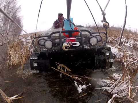

        This next video may seem a little tame, but this is actually a very difficult place to run,as this ditch is 4-6 feet deep, and full of large floating bogs,also the video is heavily edited,as it started as a 15 min. clip. I would also like to add that at no time while making this did I ever even come close to getting stuck. Last year with the older style tracks this was an extremely difficult run. Hope you enjoy it.
        in the ditch 2013 argo 750 HDI - YouTube

          cool. Thanks for taking the time to shoot, edit, and upload. Sometimes it's hard not to end up with a video that's too long.

                    Great video Foxvalley ...looks like you might be right about the "Doug Special" ...lol... I was concerned that with such an aggressive serrated winter cleat on your 18.5" Adair belted track that it might just load up with mud and long swamp grass...we made some design improvements to help release the grass clumps on this generation of "pro series" tracks and it appears to not only give a superior bite, but within just a rotation or two it leaves all the debris behind and is keeping the track very clean...
                    Love the angle of the camera for studying the results of the design improvements.
                    Thanks for sharing your fun with us :-)
