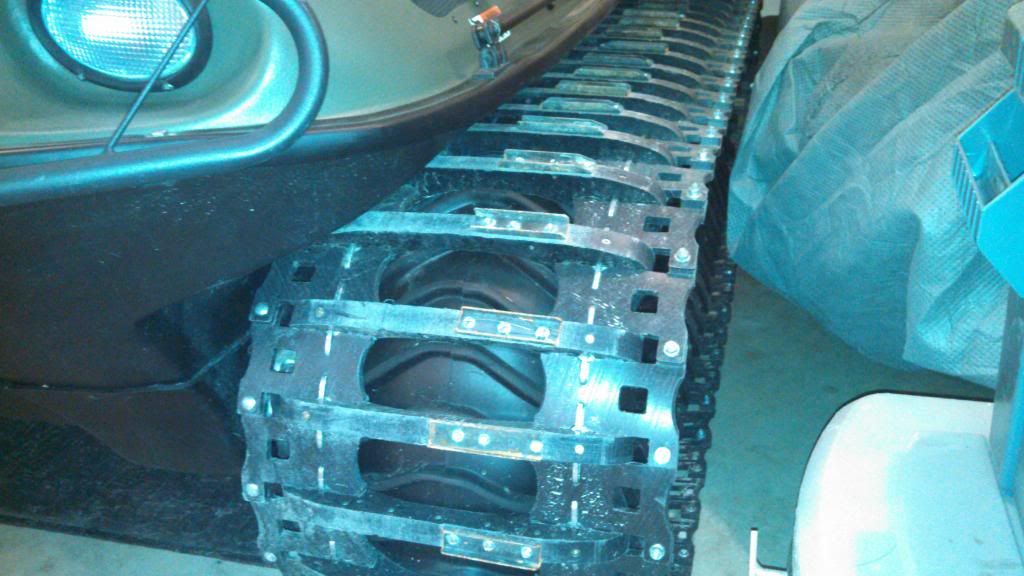

    I love my ADAIR 18 inch snow tracks with the exception of traction on icey conditions, so I wanted to share what I did to help with this issue. I know this is a very low tech approach especially to you guys who have the ability to actually build your own tracks which I admire greatly, but due to my limited mechanical ability this was the best I could come up with. I bought 25 16.5 inch snowmobile track cleats and cut them 4 inches long and placed 1 on each grouser. The cleats are very rugged and lightweight and are secured with 3 #12 x 1 in hex washer metal screws. The difference in my machines performance in icey conditions is like night and day!!! I have not found a hill I cant climb or log I cant crawl over. On a prideful note, a ride this past weekend with my buddies who have UTV's and tracks proved that I can out perform them now in almost every way except speed which was very redeeming!! I had zero issues with the cleats as they all stayed firmly in place with no bending. I was not sure how much they would enhance my tracks performance initially, but so far they have really exceeded my expectations!!!! my total cost was approx. $120edia/IMG_20140205_062701_431argob_zps6a39f126.jpg.html][/URL]

    I love your cleat setup,simple, yet it looks to be extremly effective! A great way to add traction to your setup.Kudos.

                        bigbuck- as stated earlier, I like what you've done to add some traction to your uhmw crossers. Looks quick and easy to zip in some fasteners.
                        Also, I would love to hear any feedback you have about snow/ice buildup on your u-shaped cleats. The only reason I ask is because a lot of us have had big time problems with "voids" in the HDPE supertracks filling in with snow, and I know the same thing can happen to metal very easily in the right conditions...especially if it's in a "u" shape. That's why I prefer verticla steel, or a cleat with only 1 vertical wall (and also some aggressive height). That's my main complaint with u-shaped cleats..you can find yourself in conditions that will pack the void full, rendering it much less effective or even useless. It would be easy for you to zip in some taller angle if it does start to cause you problems
                          Hey Buzz, yes these cleats will pack with snow at times, but for what I do and where I go, it hasn't impacted my performance. Even if they pack it seems that just having the outer sides on the cleats is all I have needed for climbing the hills that I climb and the logs I have gone over. I just cruise the clear cuts and run the ridges. For me these cleats have given me all I need. My buddies that I ride with have been very impressed with what the machine will do now...... For you maybe not so much...In all do respect, I believe that you are definatley in a different league from me. You are a master as where I am just a grasshopper!
                              no no my friend, not a master. But the more input the better. That makes perfect sense how you describe it and how even having some extra height and step-offs on the plastic seem to help you quite a bit. Thanks for that! I hope it didn't come across like I was doubting your cleats, just curious that's all.
