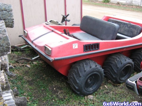

What kind of machine do you have, and where are you located. I have some trailblazer rims that are 10" with a 3 bolt pattern. If you could fit 24" or 25" tires, you may be able to find some cheap quad tires that would mud pretty good and fit them.l like to buy stuff and no I don't do payments!
When Drew says Trailblazer tires and wheels he means the ones like these in the pictures. Armstrong made the tires and wheels specifically for AATV applications. They use 10" rims, which are 3 bolt so you won't need adapters, and the tires are about 20" tall and 12" wide.
