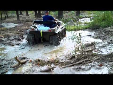

          Johnboy, you got the tracks with the metal LINKS! those are the toughest tracks made and get more traction than any other of the Adair tracks designs. Those are the same tracks that Mud Bug runs on his Argo Frontier in Texas. Mudbugs machine eats MUD!!!! You can watch Mudbug and Noel Woods in this video-Mudbugs frontier has the brush guard on front.
