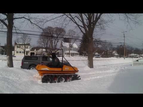

          They work ok on my Attex. Better than tires but in this powder, I'm not sure I'd be confident using them alone in the wilderness.
          This snow was powdery and almost 2 feet deep.
