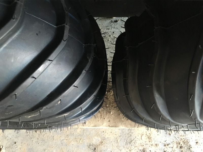

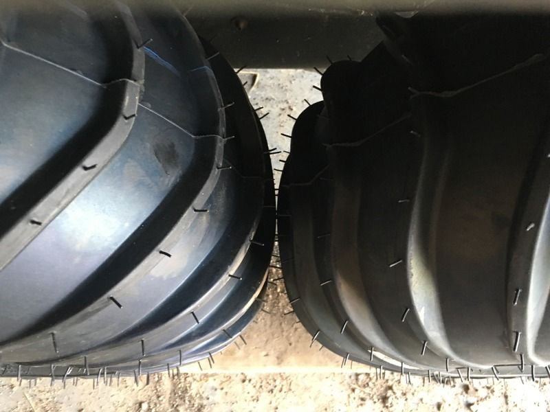

                        do you have a picture showing your tub clearance above your tire? The track belting would be driven slower than the speed of the 24" tires anyway, basically at the speed equal to a 19" tire. So long as you use track tuners, you will get the full benefit of a lower torque requirement to drive the track. So if you had the tub clearance above the tire, your axles would require the torque to drive a 19" tire to make the track work, and you would get the ground clearance and bouyancy of the 24" tire. Just depends on your tub clearance. It's one of my favorite conquest set ups, although not every tub can do it. You can even put 22" tires on the corner to simulate a banana frame like the newer machines and give a bit more clearance between axle #1 and #2, frequently a tight spot.

                            1 to 2 is the tightest fitment of 24's, though they would not work with tracks ( super tracks) ( which it appears you not doing), an 8 inch wide rim will squat the tires a tad. If you haven't circumferenced your tires yet, you may have smaller ones in the lot to move to 1 and 2.
                              Buzz - those work pretty well. I saw version 2 of the video as youtube pointed to it next. Where did you come across those, were you able to make them yourself? I see what you mean about the gear reduction affect of that type of track, but that only comes into effect in soft stuff. It's on the hard pack where I have a hard time, in which case both types of tracks would be at the ratio given by the tire itself plus the grouser thickness, if that makes any sense. The conquest has a hard time turning with just the 24" tires alone I found out today when I got the new ones out for a test. I had to use low range for anything involving turning at low speeds, unless I was in soft stuff. Perhaps I should think about replacing my whining old gears with the low range ones. I kinda had planned all along to just toss the 22s back on for tracks, they're sitting in the shed still on the old wheels ready to go. I need to take some apart and fix the leaking beads though.

                              Jim - I didn't circumference the tires, that's a good idea.
