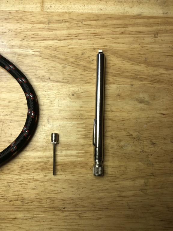

    So I dug around in my bins to see what I had and ran across a steel valve extension:
    That's great, but it still won't depress the tire's valve when attached. So I stuck the end of a zip tie in the end of the extention, cut it flush and made sure it was jammed solid:
    Then screwed it into the low pressure gauge and screwed that into the fill port on the big gauge:
    Works perfectly:
    Resolution is perfect for my use, I can bleed psi off easily and see the change right away, air up a bit if I go too low and I Still have a gauge I can use on higher pressures.
