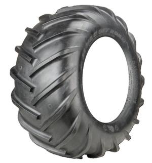

Anyone have experience with OTR 22 mag tire? How do you think these would do swimming?
Experience with OTR 22 Mag tires?
Here's the rims I ordered. I plan to paint the faces black. Not a fan of the orange. These also have bead humps just like the factory rims. They are also a tad wider and are a 10" rim. I think they will do fine.Originally posted by margo View PostI am very interested in this same set up for my vangard 2 , I really want to know how they swim. If you have a link to the rims or the rim size. I have runamuks but want more grip. These look like the ticket for swimming.
Maybe I won't get beat up. The At101 that several people are running on Max, Argo, etc are 4 ply. At least the ones I was looking at. I'm just ready to take the Vanguard out for a ride and swim. Bought it used never drove it. Needed chains and a couple bearings. Ended up pulling the frame totally out and fixed the rust issues. Replaced all the bearings, chains, seals, new motor, new belt, fixed small cracks in the upper half of the hull. Powdercoated all the metal. Fixed the grooves in the axles from the seals. Redone all the wiring.Originally posted by racerone3 View Postshould swim well, but at 4 ply they will be very stiff even with no air pressure
