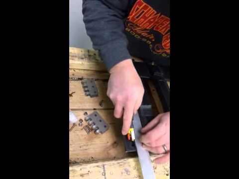

                  Ya I would shorten the tracks an inch I have attached an Adair instruction video:
                    Thanks for the video. I will probably be going that route. With the snow kit I will actually have to remove a grouser but the ones near the hinges are close together anyways.
                      As much as it pained me to do it, I cut an inch off the track AND managed to heat up the tub enough to get some of the hump out. I did a quick test run at 5 psi and no slap. I didn't measure the sag but ran in some rotten snow with no problems.
