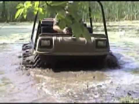

                      J wheels
                      J wheels in action on you tube I dont know if i can creat a link or not but I will try.
                      these things do healp flote alot a claimed 500lbs extra flotaion. if my link dosent work try to find it its worth it
                      • #26
                        It's hard to tell in the video but do they slow your water speed down some? They looked good in the mud coming up the bank.
                        • #27
                          Speed
                          That Max IV with the J-wheels is swimming much faster than mine with 25" Rawhide IIIs. Also climbs out in mud much better. Great improvement in floatation, stability & traction. I'd be curious if there is a sacrafice in ride by stiffning up the sidewalls.

                            I think the speed you see is probably from the 26" tires. Those are very fast in the water compared to the rawhides. It looked like the j-wheelz may have even slowed them down some ?
                            • #29
                              Toyman,
                              There is no change in the ride , because when the J-Wheel is attached to the rim. When you,re driving on hard ground the J-wheelz are off of the ground. But,, in soft mud the J-wheelz only allow your amphib to sink so far. This allows your tires to grab traction , several inches at a time. The key to driving in very soft and deep mud , when using the J-Wheelz , is not to spin the wheels very fast and cancel the traction out.
                              The J-Wheelz are superior over tires in soft, deep mud , as seen in the video. Max King tried driving out of the lake with the Terra tires , but , the mud was so soft , that he got stuck every time that he tried. He then went back and installed the J-Wheelz , and later was able to drive out of the lake in the very same spot.
                              You can remove a J-Wheel in a little over 3 minutes time.

                                This video shows how stable the J-Wheelz are in water ,compared to tires.
