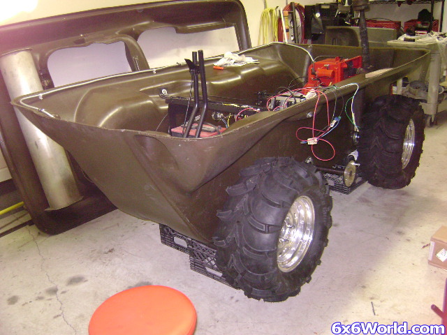

                  Well I decided that this spring I will be selling my set of Goodyear 26x12x12 Super Terra Grip tires that were factory tires on my Hustler BIG FOOT and jump on the Mud Bug band wagon. I made that decision after I saw a fellow forum member's Hustlert BIG FOOT rebuild with some 26" mud tires on it (although they arent Mud Bugs) and I said that its a must have. I would assume that what I have heard about them being decent in the water is true because they are shaped just like a Goodyear Rawhide III. I hear that these Mud Bugs are pretty impressive in the mud, which my BIG FOOT is primarily for.
                  It sure looks like this machine means business!!!

                    JPSWIFT1-Congradulations on your choice for a big aggressive tire-your water speed may not be as good as the Goodyears but with everything else you will never look back. Matt recently conducted a water speed test on 25" mud bugs with the v facing forward they gps'd at 1 mph. Not a great water speed but look what you get in mud eating ability. WOW! Hey please tell me where you got those aluminum 5 lugs rims? Are they 8 1/2 inches wide? I want a set for my Max. Please let me know okay?

                      Looking good JP
                      JPSWIFT1
                      I like the way that thing looks,what a BEAST !!!!!!!!!!!!!!Man, your doing a really nice job on building that Hustler. Jp, the tires need to go on the other way. Look at the arrow on the side of the tire to show the right way.With the tires being on backwards , they throw alot of water up in the air (all over the place)!!!They wont swim very good with them being the wrong way.
                      Remember, these tires are not Amphib tires , which every one puts on backwards , they are(atv) mud tires . Man , you will really love what they will do for your beast. Its looking really good. I put some 25x12x9 mud bugs on my 72 Max2 , and it sure changes the way the car looks, thats for sure.
                      • #26
                        That is actually not my Hustler, that is the Hustler that influenced me to put these tires on mine. I am actually already done with my restoration. I just wanted to show everyone what fellow 6x6world memeber, Meinfield did with his rig. I dont really know where he got those aluminum rims, but maybe he could tell us. Anyways, if you put the treads backwards on the Mud Bug tires, will water speed increase?
