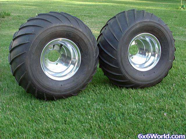

    I think I'll be able to help you out with this. I am going to be running ITP Pro T-9 .190 thick polished aluminum wheels on my new Attex Thunderchief racer. The only issue is that they're not too easy to find in 4x4" bolt pattern. If you are looking for ones in a 4x4" bolt pattern you would want to look up older Polaris models like the Trailblazer 250 because they used this bolt pattern. I ended up using two of these and I found 4 more cheap on ebay for a 4x100mm bolt pattern (Yamaha Blaster). Mike was nice enough to make me up some 3 bolt to 4x100mm adapter plate templates to use for my racer. I do know that Whipper runs aluminum wheels on his springer (he redrilled his rims for our 6 wheeler 5x4.5" bolt pattern) and I don't think he has had any issues. Also, here are some aluminum wheels from a golf cart place, but I really don't know what thickness the aluminum is.....you might want to ask them before placing an order. They are a 4x4" bolt pattern though.
