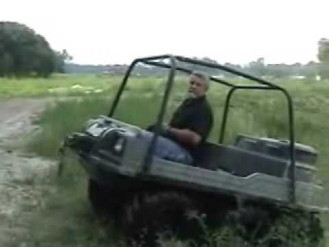

I have had 27" swamp fox plus tires on the machine almost since it was new. I took the goodyears out a few times and got stuck several times in what I would consider easy mud conditions. Goodyears came off Swamp foxes went on and great AATV riding every since with the Max rarely getting stuck and when it does it is under very extreme conditions!!!! Now to answer your question. I have the 27 horse Kawasaki engine and I haven't experienced any problems turning. As a matter of fact I think it turns very well and doesn't seem to put any undue stress on the frame or drive train! Since the Vampires are so hard they actually seem to skid steer a little better than the swamp foxes.Originally posted by thejunkman View PostDo these tires make your machine hard to turn I have heard that aggressive tires make the machine very hard to turn.
I am going to post this video so you can see for yourself how little effort it takes to skid steer this machine. (P.S.-I think the 26" Goodyears were actually harder to turn than the Swamp Foxes!)Last edited by mightymaxIV; 11-04-2007, 05:03 PM.
