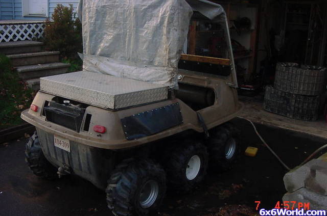

                Thank you guys / Actual Pictures of the Jackal Tire
                Now here is the real issue at hand. You guys that can purchase a Rawhide III for $40 to $50 dollars are killing me. The differance is location. I am in New Brunswick Canada where we pay with body parts for such things. I priced through out eastern Canada and the least $$$ for the Rawhide III is $91.36 and he tells me this is a deal. Most others are around $125 to $130 so for here that is a deal.
                Now here is what I am hoping will happen. At $35 each it is almost worth a chance. The tread design on these Jackles are similiar to a v pattern. I will attach a picture of one. I am going to see if the 22" Jackal will fit in under the MaxII and if so I will buy them and report to you all how they work.
                Now in the picture I have put a level across the jackal and a 21" GY.
                The Jackal has 5 lbs of air for now but I will lower it to about 3.5 And the size diff is apparent. i will swim them with all facing to the front as I think I will get most traction in mud this way. It is very important to me not to get stuck where the four wheelers get through, as at any speed in water I am ahead of those other people with the 4 wheels.
                I think the tread design is not too bad but will know come the weekend.....
                comments are again welcome as I really need the support both pro and con to keep me from going to the dark side.......4 wheels that is....
                Mike S

                    Bringing back a thread from the dead.
                    Hey Moike, any update on the performance of the Jackals?? I saw in your picture gallery that you said they swim better than the Rawhides.
                      ( QUOTE ) Moike " I have put it to a swim test , and they are far better than the rawhides. "
                      Well , I guess we can add the Jackal atv tire to our list of non-amphib tires that swim. They have a wider lug spacing , so they must shead mud much better than a Rawhide tire.
