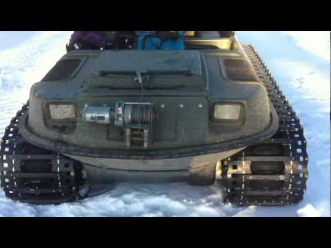

    OK, So I managed to get some things done. First off, I did get the tracks converted over to the wider spacers and am now 18" wide. That was a bit of a job, but nothing that a couple buddies and a few drinks couldn't handle. Right now I've gone with 1.5" x 1/4" bolts through the extensions, but I may up that to 2" bolt in the future if I decide I want a little more. I've put one Cleat on every 5th Grouser, staggered, and also on that Grouser is 1 Gold Digger Stud. There is also 1 Gold Digger Stud on 2 of the Grousers between each Cleated Grouser. I worked my way up to that fairly quickly, but stopped there as it was feeling pretty good.

    I tried a little "Spinaramma", from WOT on the road, and as you can see, the tracks are biting in hard. Pre Cleat/Stud, I would probably ended up 50yrds further down the road.
    I'm not standing very far in front of the machine
    Now that the tracks are wider, I have installed the Track Tuners on the center axles, and Standard Axle Extenders + 1/4" spacers on the front and rear axles. We went for quite a long ride today with both machines. Mostly Hard pack trails and Winter Roads, but also about a half mile up a frozen Muskeg Creek. The creek had some nasty deadfall, a few steep banks, small Beaver dams, ect. I have to say that, in their current configurations, the Adair Tracks outperformed the Supertracks in every situation. Not once did we slip a tire in the Adair tracks, with only the front and rear tires driving. We had a med load in the machines, 8 of us with a bit of winter gear (just in case).

    Keeping in mind that this trip had many "Firsts", and was not a long (maybe 10 miles) or technical ride, I have nothing but good to say about the Tuners and the Tracks. I might go so far as to say the Tuners improved the performance of the machine, but there is no way to prove something like that, way to many variables. But the machine did "feel" very good, and had no problem keeping up to the machine with 30% more HP

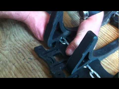

                          Well, it's been a while coming, but here is a little clip from when I widened the Adair Tracks. It didn't turn out very well at all, I had issues with my VIO POV1 Headcam, so all I managed to get was some footage with my Cell Phone. You will still get the idea though. Procedure was to split the tracks, then take the end Grouser off one side. Then move one Grouser over one position, replace the narrow Spacer with a wider one, then move the next Grouser over. work through the tracks and then finally put the original removed Grouser back on at the end of the track.
                          I did break a couple of the screws, and had to try to get the broken piece out of a couple of the Grousers, but it was not a big deal.

                            Hey RD...as time goes by we are getting a little smarter with the wide tracks and I just wanted to pass on some new things we have just recently learned...first, when you assemble the wide track with the wide spacer, if you lay the next spacer UNDER the last one ( instead of on top of the last one) then it helps by opening the gap up for the chain to fall into instead of pinching it closed and requiring pliers to force it down into....another helpful change in the last week or two is the little rectangular plastic plugs that drop down into the chain link are now CNC'd for a perfect fit and less bloody knuckles...lol
                            Wish we had learned all of this before you went through the process of converting yours and I could have saved you a lot of effort. Thanks for getting some good video and helping show the process so it is a little easier for others to see whats involved :-)
