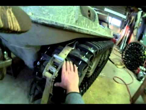

    Anyway, I did get the tracks assembled, and mounted on one of the Conquests. Too early and COLD out to form an opinion yet. They look like they will work for me. I did run around the yard untill my hands started freezing, up and down the hill in the back yard. Climbed the hill with no issues. I suspect that I might want some type of ice cleats, was also ripping up and down the road a bit, and I can tell you these tracks like to slide sideways. It's very fun once you get a handle on the situation.
    So, this is a clip of the Assembly and Installation

      ......Great, so it looks like I made a little mistake. I missed the part where I was suposed to put a little plastic plug in the chain link that sits righ inside the grouser. The screws drive in through the grouser, through the plug in the chain link, and into the grouser again on the other side. Don't you hate it when you mess up, then proudly show your screw up off to your friends.
      Anyway, I gues I might get to see how well the tracks come apart, compared to how well they went together

              After discussing my options with Tim at Adair, I opted to have the tracks shipped unassembled..... Disassembled?.....not assembled?.......not put together?
              Anyway, there was some assembly required. I believe that this saved me money in shipping costs, although I'm not positive on that as I have not tried to have an assembled set shipped. These tracks arrived in 5 boxes, and I did get some dirty looks at the post office for the weight if those. I'm sure the pretty ladies at the post office would have broken a nail or something if they had to deal with an assembled set.
              I'm sure you could have them shipped assembled if you choose to, although I'm sure they would arrive stacked on a pallet, not in a box.
              For sure I've only had a taste so far by climbing that hill. I did notice that the new grouzers are very sharp edged when new, and I figured that helped get up the hill. I suspect that the edges will " round off " over time. Tim also took the time to send me a pic of his ice cleats that can be added to the track grouzers. They looked like they could Ripsaw through ice and hard pack very easily. So far, I have not ordered any, my intent was to get tracks for Summer mud and muskeg, but I still might get some just because they look and probably work awesome. I could always take them off in the summer. Save them for the Snow Tracks that I will probably order in the future.

                RD, I've been thinking of buying a set of Adair tracks for my Frontier, because they'll fit my 25 inch tires. I'm waiting to see how they perform in snow. I travel through one to two feet of snow to my fish hut. Just wondering when the chains in the track stretch, and you can't control it with air in the tires, do you remove a link in the chain to tighten the tracks?

                    RWT, you remove one grouser, cut two links (About two inches) and put it all back together, you should be able to run like that quite awhile before you need another adjustment, if the tracks get a little slop you can control it with air pressure. Are you running 25" Rawhides or the 25" swimmer tire? If your running the 25" swimmer it's going to be very close clearance wise because the swimmer tires run pretty tall, the rawhides generally sit about 24 1/2 inches tall.
