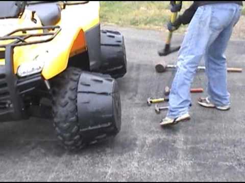

          This video shows how durable the J-wheelz are.
