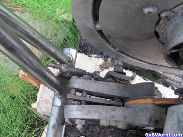

                  http://www.6x6world.com/gallery/data...m/DSCN4697.Jpg . Brake pad noise is possible, remove the firewall looks at the break discs and they will either have 2 hydraulic calipers with pads in them or if manual 4 aluminum pieces with the brake material riveted or bonded to them, the brake material new on either set up is about 1/4 inch thick and on the hyd. set up should be twice the thickness of the metal that it is bonded to.
