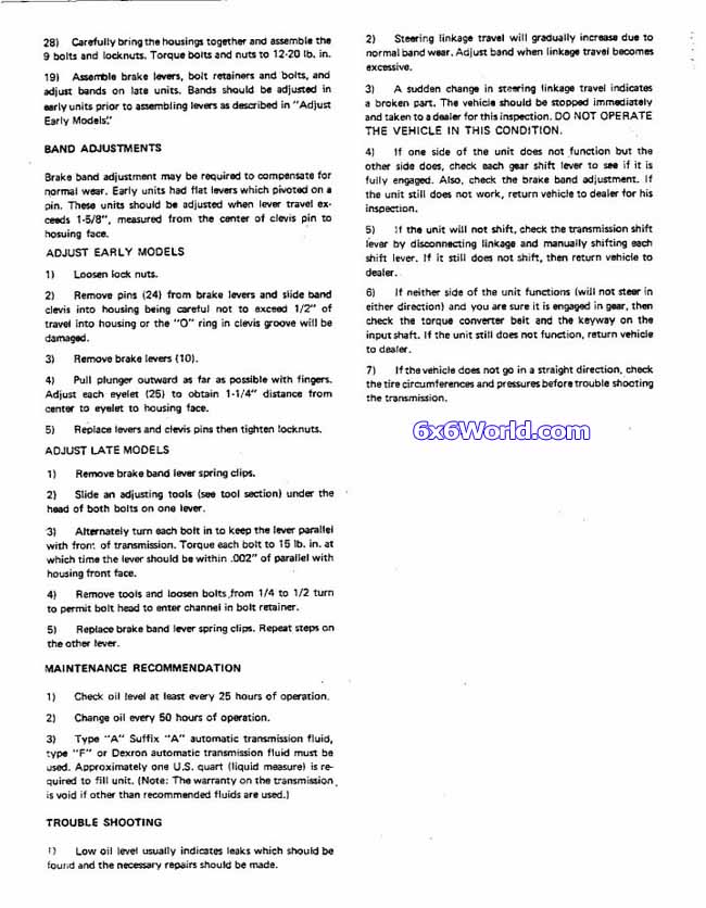

    What happens when you adjust the tightness of the Ubar bolts at the top of the T20 transmission? Am I right in assuming that the steering gets tighter as you pull on the laterals because the springs get pulled tighter? My ubars connected to the top of the t-20 are about 1/4 inch out from being tight is that normal.

    Adjustment procedure. http://www.6x6world.com/images/skid-...-manual-15.jpg
    Typically you want to adjust top and bottom evenly. Ignore the springs, it is easier to adjust with them removed too. I keep my bands a little on the tight side, but I'm sure this does cause premature band wear.
