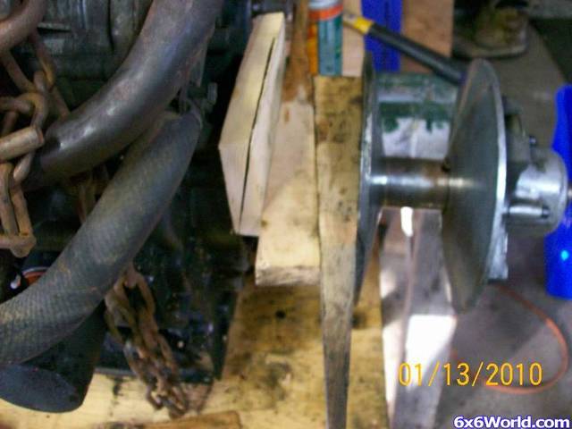

          Believe it was racerone3 who had shown a homemade remover just using 4 wooden wedges/ shims. Looked like a good idea.
          Wrong on that, was bbass
