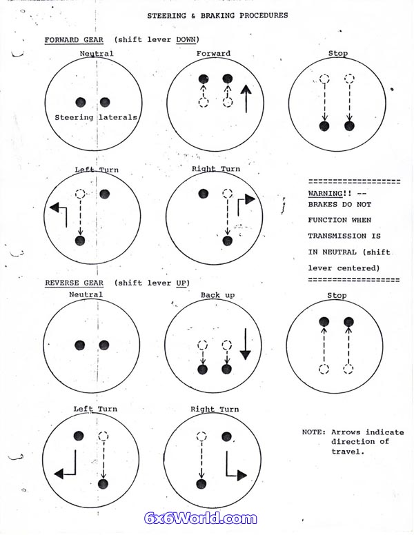

    I have a Max II and working on rebuilding a hustler.My question is how dose the T20 work?On my Max II in forward I give it the gas and it moves and to steer it by pulling back on either stick depending direction.In reverse i give it the gas and it don't move till I pull both sticks and releasing one or the other depending direction.Is this correct or is it in need of some sort of adjusting?
    When in revers, pull both sticks back. To steer just let off one side. Your springs are loaded forward. So you are doing it right!
      Great, thank you now it all makes some sense.
        This should be the operating procedure for the T-20 from a Hustler. All T-20's work the same,
          T 20
          http://www.6x6world.com/images/6x6-h...V-Manual-8.jpg
          That,s a good page Jim. I hadn't seen that before. I just thought that we should mention that some T20 machines either did not have return springs on the sticks or they could have been removed. Some high speed types say they prefer no springs?
