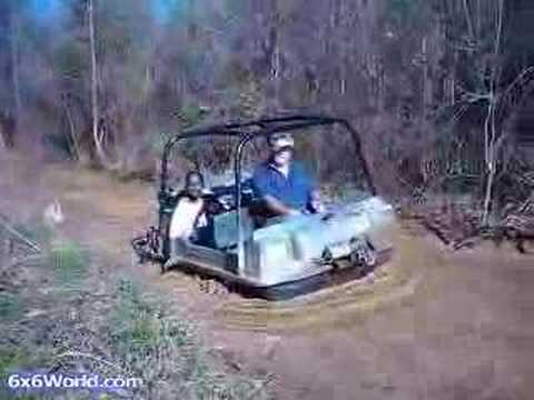

            Look at how I steer in this video. Check out the about 34sec mark, and again at 3:35sec. You will notice i have to brake on the side that starts to gain traction as I exit the mud, and in a long mud pit I have to do the same to keep straight.
            Jeff
            02 Argo Bigfoot
