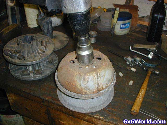

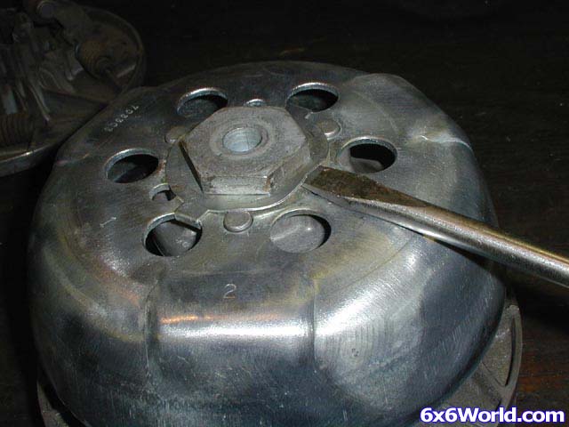

It's better to push the outer clutch face in towards the inner far enough so that it "locks" over center before you take it apart. This way the springs aren't loaded against the outer cover (ramp plate). Keep your fingers from between the pulley faces! (or it'll hurt) If you don't have access to an impact wrench to pull the retainer nut, it's easier to flatten the lock plate and loosen the nut before the clutch is removed from the engine. If the clutch is off the engine, I always use an impact wrench when possible- it makes it lots easier.
When the cover's off you see the guts of the clutch. With this particular unit it was easy to push the faces together and once inside it was easy to see why: only one spring was intact. Usually it's easier to remove the hex bolts and release the spring tension before the spider is removed, but in this case it wasn't necessary.

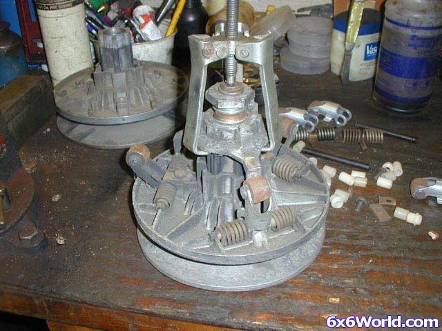

Use a puller on the spider and pull it straight off the end of the hub.

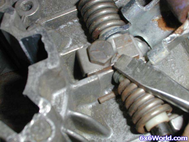

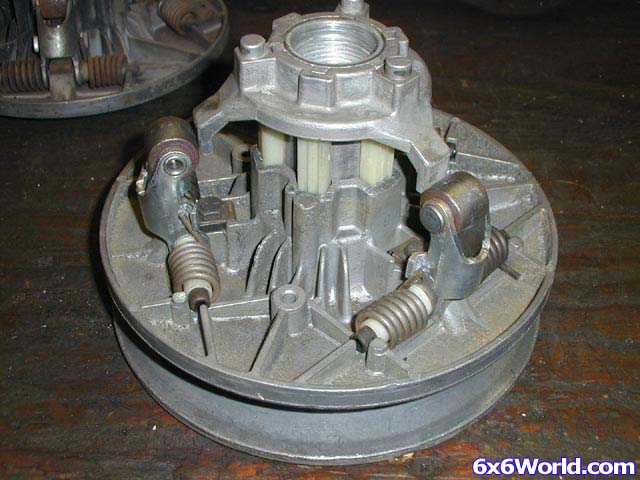

Once the spider is off, the moveable face can be removed and disassembled. Release the springs from the roller arms with a pair of pliers or a screwdriver, then flatten the locks around the hex bolts and remove them.

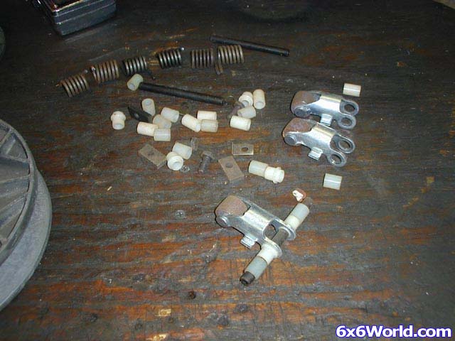

Remove the rollers, bushings, and arms from the moveable face. The only thing left to remove are the nylon spline liners from the fixed face of the clutch. They should pull off easily.

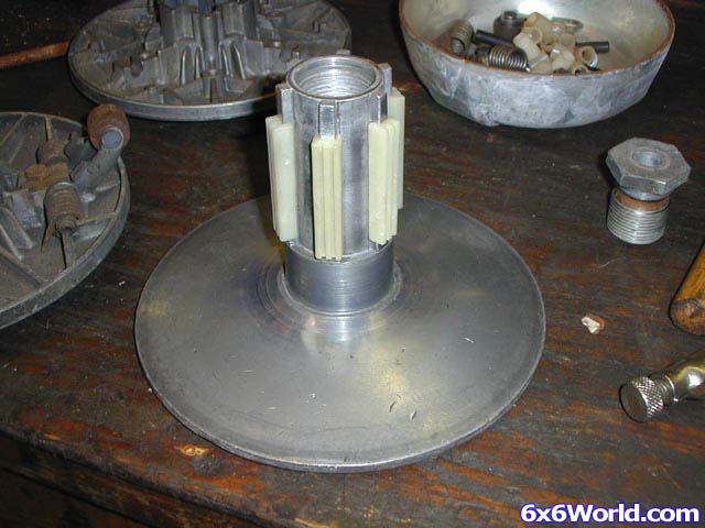

Now that everything is clean and you're satisfied that all the parts are useable, start to put it back together. First put the new spline liners on the fixed face hub.

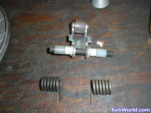

Find the right bushings from the kit for the clutch you have: most of the kits I've had are used for more than one model, so there's extra parts and you need to sort out the ones you need. The collared bushings fit into the roller arms. The 910 will use the longer nylon bushings from the set - make sure they are a good fit between the boss in the clutch and the collared bushing.

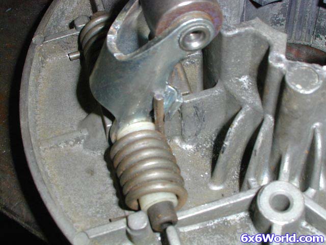

The new springs will have one leg longer than the other. The longer leg of the spring will be on the inside to locate on the tang of the roller arm.

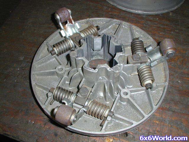

Fit all three sets into the movable face casting.
Then install the metal locks and the hex bolts and torque to 5-7 ft. lbs as per the manual. Now bend the locks over one flat of the hex.

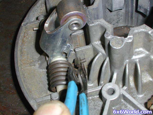

Here's where the fun begins. There's a special tool for the springs, but I've never seen one. People always laugh at my tiny Channel locks, but I've never found anything that works nearly as well for this type of thing.
Pull the end of the springs over the tang on the roller arm on each of the sets. It may take a couple tries to get the hang of it, but it works.

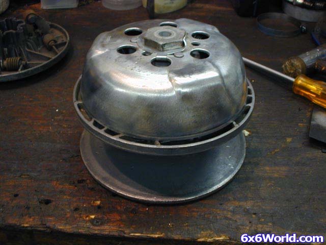

Now you can put the cover (ramp plate) back on, making sure the push-outs in the cover are directly over each of the roller arms. Install the ramp plate, retaining nut and torque to 150 ft lbs. Bend the lock plate over one flat of the hex.
