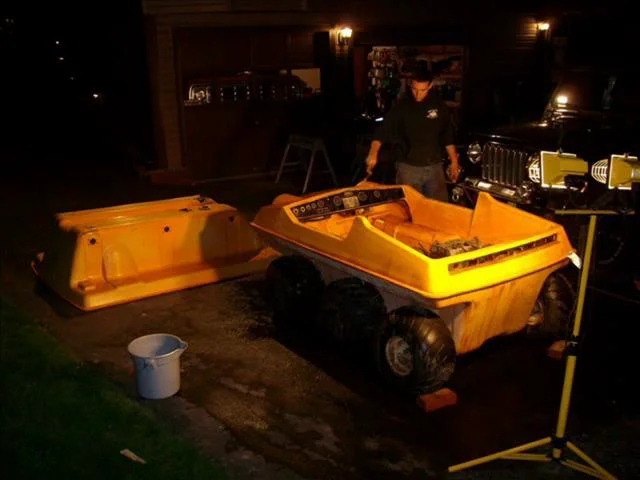

    Evil came up with a way. Check the 3 minute mark in this slideshow he posted.
      t/20 clutch
      take and support the clutch up with the skid steer hanging down and bolt removed apply some rust penetrent and use a blunt drift punch and drive the shaft out of the clutch..use wood as a support..it will take 2 people to do this..i made a wooden box from 2x12 and 4x4 under them and thick rubber under the skid to keep it from being damaged when it droped out....be carfull
        GREAT VID
        nice to follow along with the build. GREAT looking machine guys and doing it together. I like the lighted flag pole bruiser is jealous do they sale them in blue?
