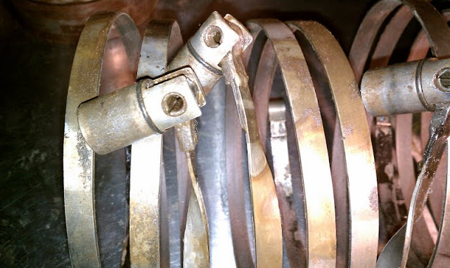

                        I have a close friend that is a machinist that has his own mill and lathe. I am going to take the drums to him and have clean and true the brake surface very lightly. Is this a bad idea. Can you give me a suggestion for the relining. I am not in a big hurry, just want it to be right. Do you think they will straighten the bands? They have been twisted on the ends from improper adjustment. Could you let me know who could do the relining?
                          That's stange that the ends are twisted. Do you have a picture you could post so we can see how bad they are? For relining, see this thread: http://www.6x6world.com/forums/trans...html#post65459 That's the cheapest place you are going to find.
                              Never have The Hulk adjust your transmission again. Holy Cow! It won't hurt to try and straighten them out, but I'm not sure it'll work. Alabama Bands might be able to do it better.
