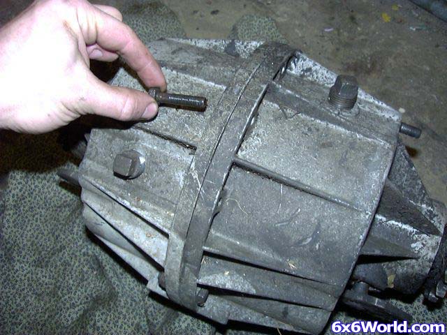

2. Begin by taking all of the nuts and bolts out that hold the two T-20 halves together.

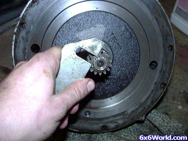

9. You will repeat the same process with the other side of the T-20, but first you have to remove the large round plate that covers it. Your best bet is to use the metal shifter retaining piece that came on the later model T-20's to take the "C-clip" off of the main shaft. If you don't have one of those, you could probably fabricate something to help. Tap it with a hammer, but hold a rag up to the shaft because it will go shooting across your garage and there is a good chance that you could lose it. Sometimes this step takes a couple tries since there is so much "spring" to the C-clip here.
