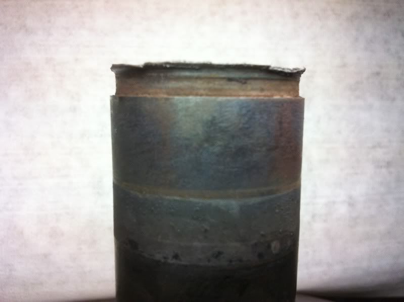

So, I was servicing my Clutches, and came across this:
Just wondering if anyone else has come across this problem? This is the groove at the end of the Secondary Clutch Shaft, where the Snap Ring mounts. As you can see, the Snapring has just about worn through the end of the groove. If this had come apart while on the trail, I would have been screwed.

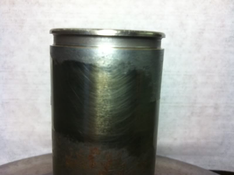

Here is a pic of my "Spare", which is fine, looks new.
Now, as some of you know, I run my Secondary Spring in Position 1. Perhaps this is caused by the extra spring tension? At this point it's just a thought, Since I am not the only guy that runs position 1 (and you may be running yours here at my recomendation), I would ask those of you that also run in position 1 to check your Secondary's just to make sure that you are not damaging your Secondary Clutch Shaft.
Thoughts?

I still have the clutch off. I think I may just put a longer key in to be safe.
