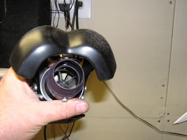

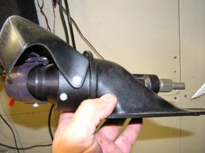

                              1/4 Scale Hamilton with reverse
                              40lbs thrust at 12,000 rpm
