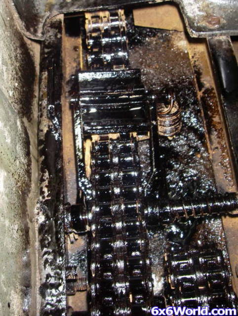

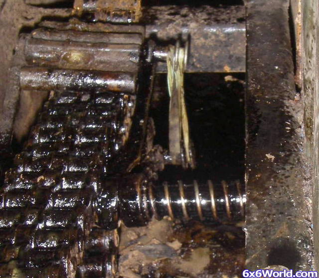

chain tensioner
april 4 08 002.jpg[ATTACH]1[ATTACH]
I have a 1979 argo, with the nylon block tensioners. her are some pics, I hope this helps you out.
