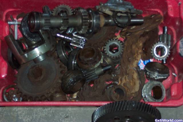

              You may end up with this when done, I suspect at least 3 of the dif. gears are broken, the bolts holding the cage to large gear may have broken also.
                Thanks for the info. How does that happen? I wasn't going crazy. Well not this time anyways. Lol. I have changed the the idles bearings on the right side of the machine, and had the brake cliper off on that side. So I know at least on side will be kind of easy. Should I tear it apart myself, or should I find a rebuilt one? That looks pretty intimidating. Really appreciate the help.
