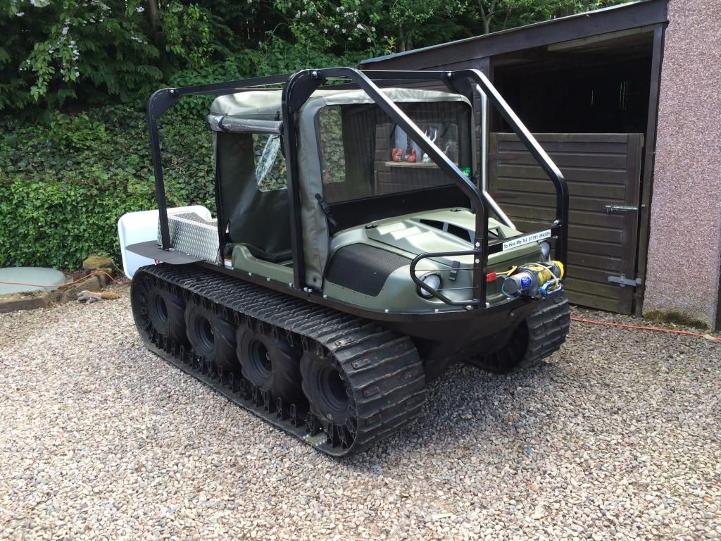

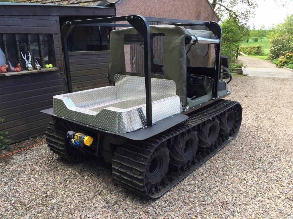

I bought this hdi around 8 months ago.
I replaced all chain and bearings, brake pads and band serviced and fitted a few extras.
Still to wire up rear winch and fit seats. My mum made the canopy cover for me, the liner was made by a friend and I have done the rest. I also have a roof rack, 8 led work lighten reversing camera, I phone dock and a few other bits to fit, here it is as she sits just now.
It was in a sorry state when it arrived home originally. It had been sunk to the bottom of a loch (huge pond) the tub was full of grease, and general crud. The windscreen was smashed, 4 of the tyres were wrecked but it was a good base for a project.
I will upload more pics as the project progresses.

How long was it under water, has it not got into engine / transmission etc?
