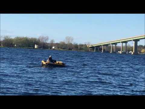

        Hi Folks, I got a new electric trolling motor. I couldn't wait to test it but the water was rough. Here is a short movie.
        When I get the chance to give it a better try, I will report.
        Last edited by Mike; 05-19-2016, 07:38 PM. Reason: embedded video by using filmstrip button
        • #19
          What size trolling motor is that?
