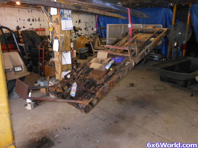

got two chains on. just ordered two flanges and a winch hoop along with new brake pads,they dont make the winch plate anymore so has anyone fabbed their own or any ideas on how to make one?also the picture you see below of the bearing extension bolt holes,they dont line up with the frame and i cant thread them through what can i do to fix this?
For the bolt holes, it looks like you need to raise the frame from inside the tub so that they will line up. For the winch plate, search the site. I think there are a couple of threads with photos. I'm not very knowledgable when it comes to older Argos so I don't know all of the differences but here's a thread with a picture from ArgoJim: http://www.6x6world.com/forums/argo-...tml#post197612

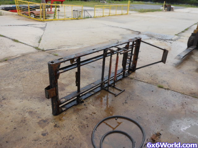

Here is a picture of a home built one I removed from Phil, guess it would work.
