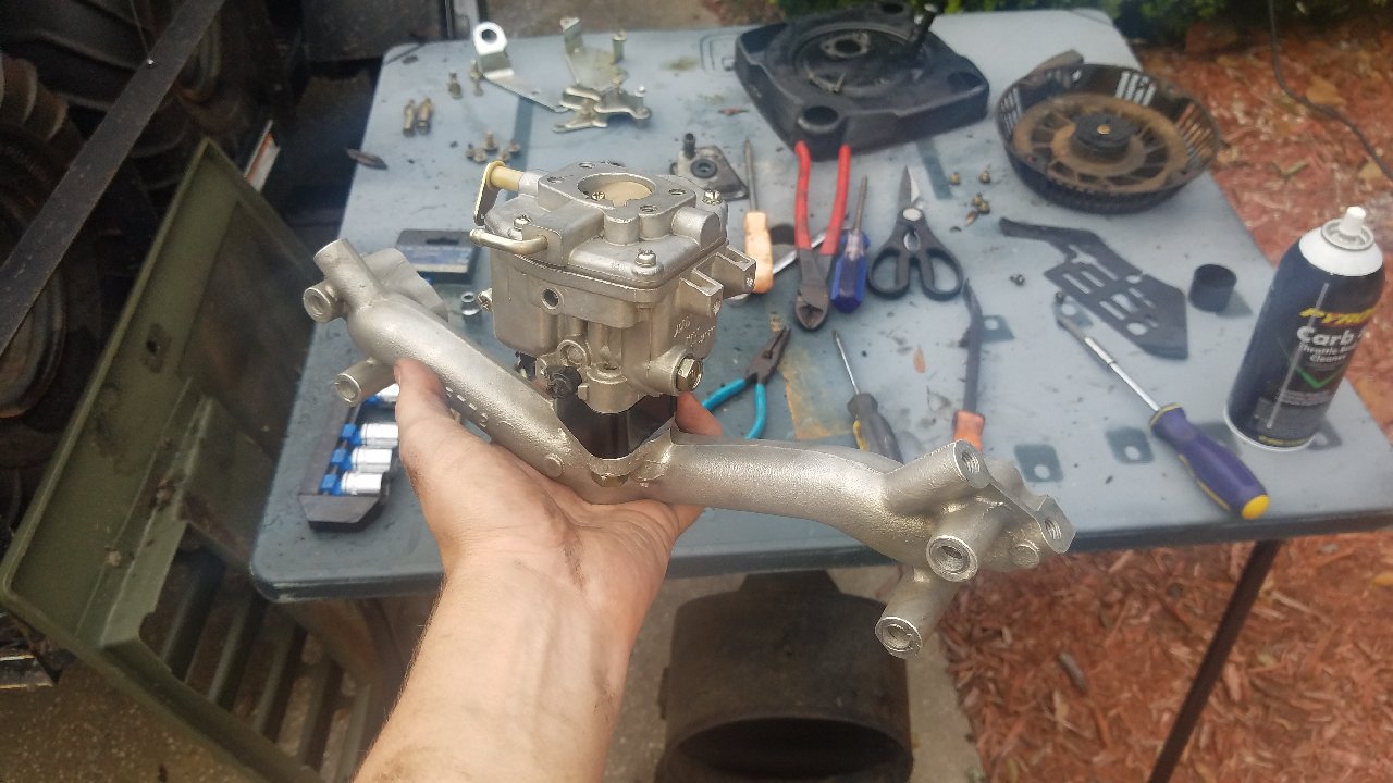

    I knew I needed to pull the carb off and clean it out at least, and when I did I noticed there was still standing water in the intake manifold... So it all came off, intake and all. It got a good cleaning all the way around, inside and out. Bolted it all back on, without replacing anything at this point, just giving it a good cleaning and reassembly.

    But something still wasn't right with the carb. I couldn't get it to run right. It would fire right up, and even idle sometimes, but if you gave it any throttle, it would rev up fine, and when the RPMs came down, it would just die. It refused to come down from RPMs without just stalling out. Also when it was running, if you gave it 1/4 throttle or so, it would just surge, like it was hunting for the proper fuel mixture. After playing with the idle air mixture screw, I realized that I could turn it all the way in until it stopped, and that didn't make a difference on how it ran or "idled". So at this point I figured that the old gasket in the top of the carb was just leaking and was allowing gas to get sucked straight in from the bowl into the intake, which was allowing it to run, be it poorly, and was also not letting the mixture be great at all...
    One carb rebuild kit later and a GOOD full cleaning, and the thing fired up on the first hit! The idle mixture screw actually does something now lol, and the thing runs like a top! I still need to adjust it a little, but as it is, it's completely operational. The wife and I took it on it's first real trail ride since I've had it over this last weekend, and it's an absolute blast! Need to get some new plugs for the hull, so have yet to take it in water. But it's been a FUN little project, and I look forward to putting some miles on this thing!

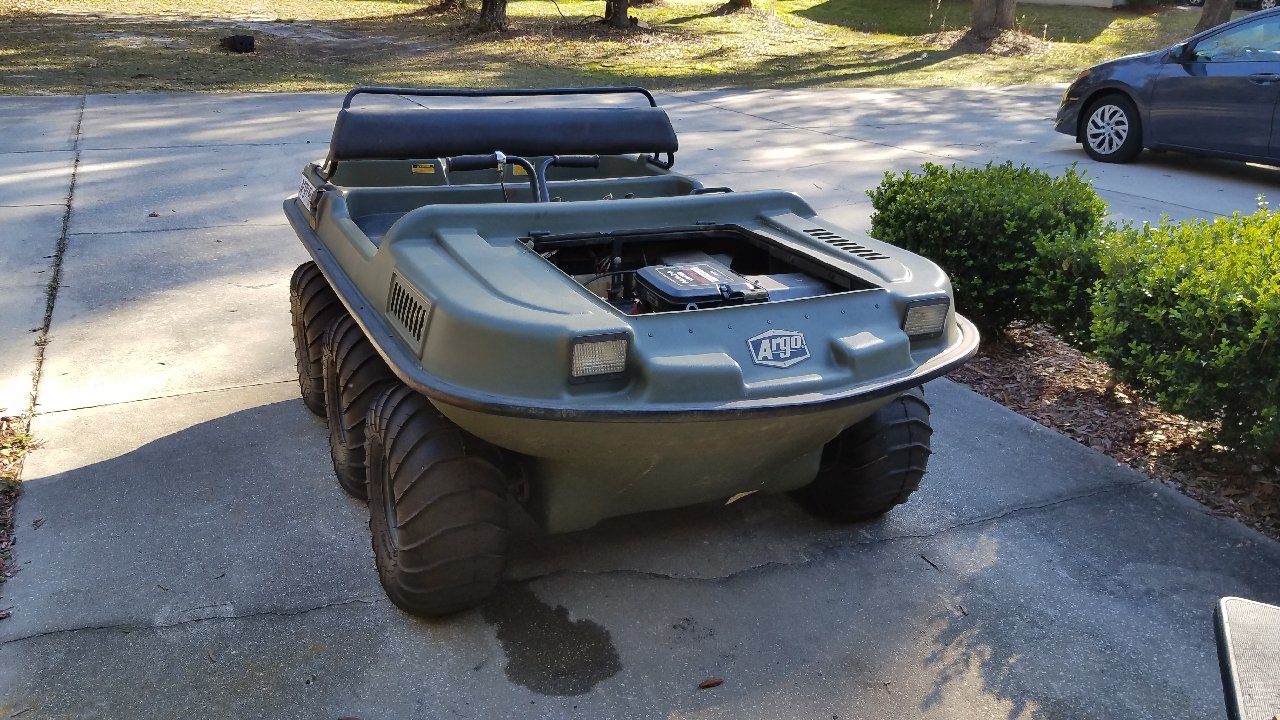

                  So last weekend we took the Argo out along with a couple Yamaha 4 wheelers that I just bought for the wife and I. The sister in law got the drive the Argo again for the first time since the flood indecent. It was absolutely ripping, we were having a blast with it! I finally took it off into some water for the first time. Talk about a butt-puckering experience lol. But she floated and worked great!
                  for about an hour...
                  For some reason, it sputtered and died out on my sister in law as she was cruising down a trail and would not restart... I haven't messed with it since, but I'm going to dig into it this weekend and see what's up. Thinking it's a fuel issue, because at first I tried to choke it and it ACTED like it tried to fire off, but not for long... So I'll start by hitting it with some starter fluid and seeing if it'll fire. If it does but won't stay running, I guess I'm pulling the carb back apart again and giving it another cleaning. Best case scenario, maybe some trash made its way into a passageway in the carb and I can get it cleaned out. Hopefully the worse case scenario is that the fuel pump crapped out and needs replaced now.
                  Either way, it's just odd how it was running flawlessly for an hour or so and then suddenly, kaput...
