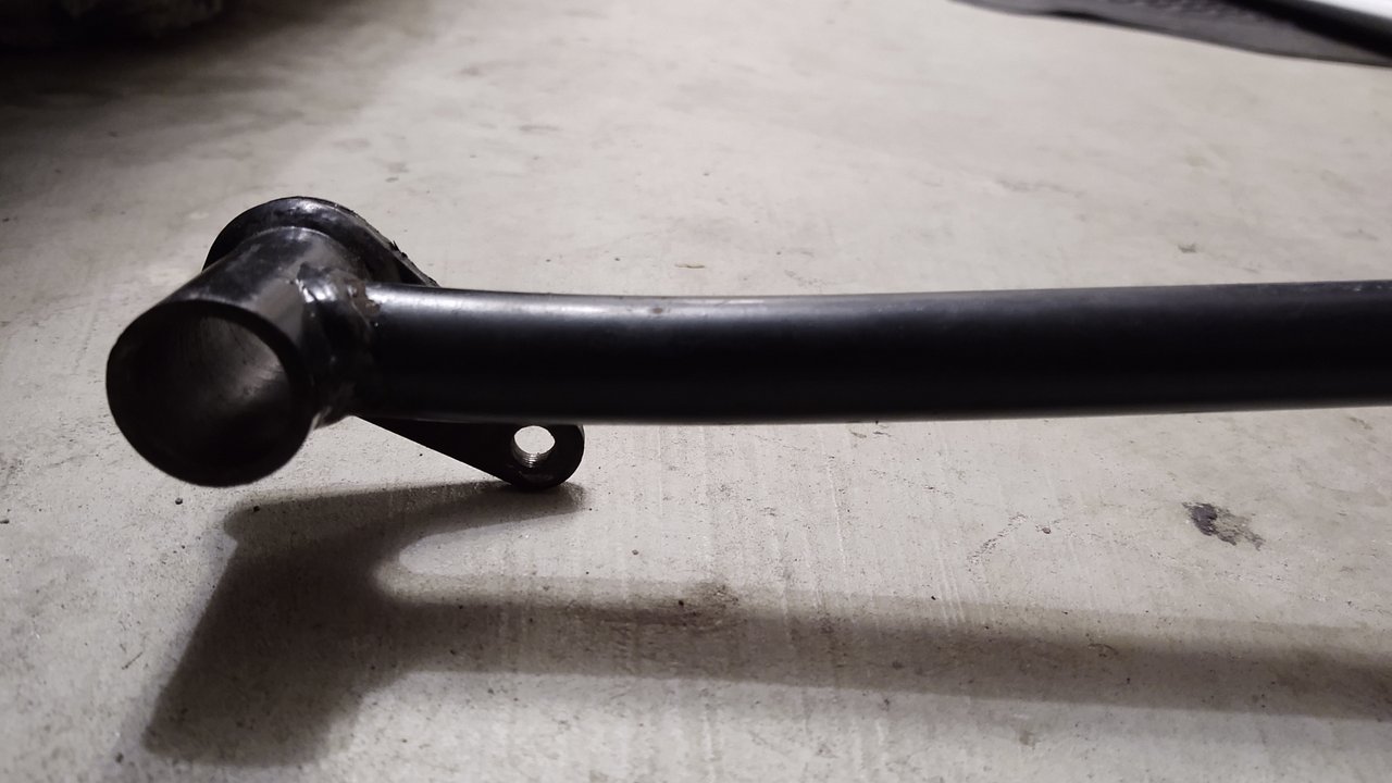

It's been parked for a little while because of one of the control levers. The brakes got rusty and stiff, and from the past few times operating it, a little too much force was being applied to the left control lever... So it began to bend pretty bad where the roll pin goes through for the parking brake latch.
Before it bent back and forth so much that it snapped from metal fatigue, I pulled the control levers off. I tried a couple places around town and no one seems to have the right equipment to bend and weld the tubing... which I think is bogus, but whatever... So I borrowed a simple tubing bender from a buddy, and with that and a Harbor Freight 90 amp flux core welder, I'm just going to make new levers my dang self!
Right one is bent just a little too. Not as bad as the left. But I'll probably end up remaking both of them.
Will end up having to cut the portion at the bottom off and welding it to the new control levers after they're bent into shape.
The new tubing is a little thicker walled, but maybe that'll just make them just a little stronger
