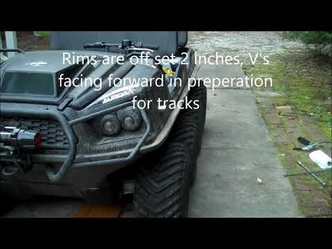

    For anyone wondering about the new Argo 950 Aurora series, I am the proud owner of a new 2020 Argo 950SX, the last one built as a 2020. It has the 3500 pound Argo winch, brush guard, full back seat and the new Argo XT119 mud (swim) tires.
    If you are considering a new Argo with these mud tires let me be the first to tell you they don't swim very well. If you are lucky on a good day you can get 1 1/2 mph out of them. As far as mud performance they are at best reasonable. If you buy a set of these for an 8x8 you can expect to get smoked in almost every situation by a MaxIV with Terra tires.
    Now for the good stuff, this machine is a beast, I never thought I would see the day when I would say an AATV is over powered. This machine is FAST. This MACHINE is powerful. I was determined to run this machine with tires but after getting stuck several times on my first day out the machine was parked and a set of Adair tracks was installed. With the two inch off set rimes reversed and the Adair tracks bolted on this machine became even more of a beast. It is blazing fast even with the tracks and the APS steering system keeps the machine going where you point it.
    Trail performance? I have never seen an AATV that can move up and down trails so quick going exactly where you point it-IT IS FAST and it accelerates and at rate that is almost unbelievable.

      These new tires are heavy, probably about 38 pounds, they are NOT the best for swimming or mud but they are an excellent heavy duty track tire. I have always run the 24" swim tire with my tracks, we'll see how well these new tires hold up.
