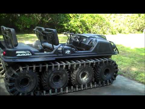

            • #21
              For anyone who owns one of the new Argo Aurora's, you have probably noticed a loud clunking rattle coming from some where on the left side and from somewhere in the rear area. The noise was driving me crazy. At idle you could hear this loud noise coming from the rear, what the heck??? I thought I dropped something into the tub that was being thrown around by the chains making a banging noise. Well I finally isolated and found out what was making all that noise. Argo has installed a wiring harness that goes down the left side of the machine and into the upper area of the rear tub. This is the harness that supplies power to the rear tail lights, it's a heavy wrapped wiring system and YES IT RATTLES and knocks against the tub! Whew, I thought it was much worse. Whew!

                • #23
                  A little video of the fix for the Argo rattle, and some video of me running the Aurora SX around my home.
                  • #24
                    Thanks for the report Dan. A few little design fixes and your off to the races. Every new machine will have a few design flaws. Probably should have some rubber grommets under the metal flooring to keep the rattling down.
