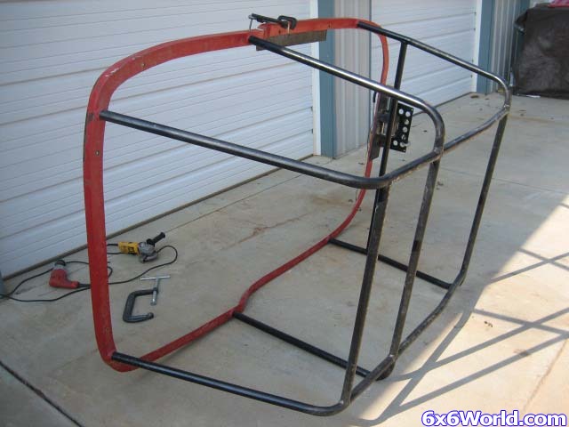

Rock Doctor, that's how I tied my roll cage in to my Max. I made a full bumper like yours around the entire Max and then welded the cage to that. I ground down the welds and painted the bumper red so in the pictures it is hard to see but here is a picture of it off the Max.
Here it is painted and on the Max (click for the big picture)

I like the idea you used on the max. I can do roughly the same on the argo. The argo has a 2pc body that's riveted. I can build a bumper & sandwich it between the upper & lower halves, then bolt it together for ridgidity! Thanks guys. I did look through the pics & see tons of ways to do it. I think this will work best for me. What size tube did you use?Jeff

Doc, I like the way that yours looks. Your welds are even and nice. My welds were a different story though
And Jeff, I have mine sitting on top of the upper body instead of being sandwiched between the two halfs. I didn't know if you thought it was between the two since you really can't tell in the pics or if that's just the way that you are going to do it. As for the pipe, I am drawing a blank on the diameter momentarily. It's poop pipe. I'm sure you can get it from lowes or home depot in 10' lengths.
